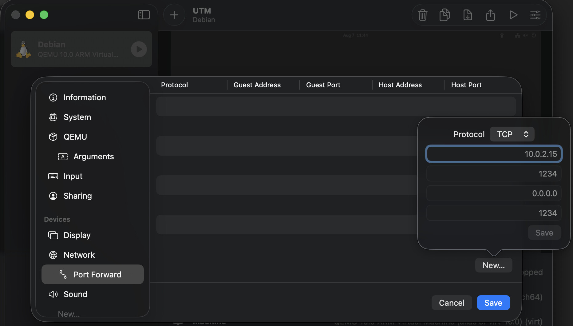

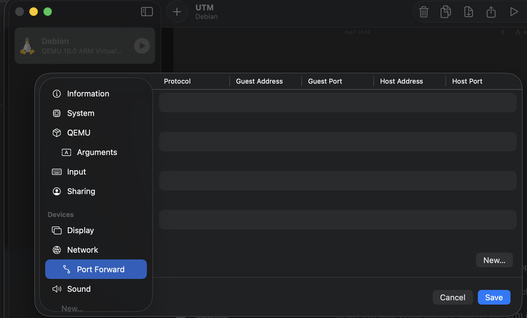

I think I found out where the IP address 10.0.2.0 is coming from. When I open UTM, single-click on Debian, go to Network, and then Port Forward, I don’t see anything. So, I clicked on New. A small window appears with the IP address 10.0.2.0. I could change the IP address. But 1) should I?; 2) would that cause problems? and 3) what IP address would I enter?
I just found the following discussion from GetHub and am reading through it: Unclear when to use port forwarding and what the network modes mean · Issue #3342 · utmapp/UTM · GitHub
